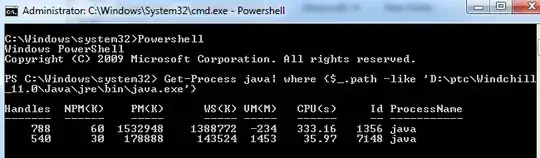

I did a bit of studying and ended up with PowerShell as an option. I get the result using two separate PowerShell commands:
Powershell
Get-Process java| where {$_.path -like 'D:\ptc\Windchill_11.0\Java\jre\bin\java.exe'}
But when I combine the two, no results are obtained:
Powershell ; Get-Process java ^| where {$_.path -like 'D:/ptc/Windchill_11.0/Java/jre/bin/java.exe'}
Can anyone help me to combine the two, or is there any other option other than PowerShell?

Get-Process java| where {$_.path -like "D:\ptc\Windchill_11.0\Java\jre\bin\java.exe"}
… works, because you apparently already started PowerShell, and manually typed this command.
This..
 Powershell ; Get-Process java ^| where {$_.path -like 'D:/ptc/Windchill_11.0/Java/jre/bin/java.exe'} enter image description here
… fails, because you are not in a PowerShell session before executing a PowerShell command.
