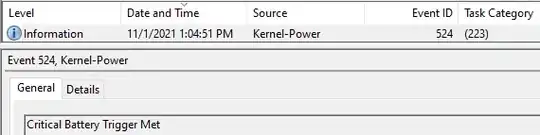

In my case, after sorting the events by 'Date and Time' I noticed an Info level event from Kernel-Power about 10 seconds earlier.
Event Viewer Critical Battery Trigger Met
Normally I would filter for just Error and Warning, but the Info event provided a clue: Critical Battery Trigger Met.
This seemed odd since the laptop was plugged in, but examining the Power Options > Advanced Settings gave an explanation.
The Critical battery action was set to Hibernate for both On Battery and Plugged in. My laptop had been unplugged over the weekend and the battery drained below 5%. Once it recharged back up to 5%, I believe the action triggered and it attempted to hibernate. I've switched my High Performance and Balanced profiles from Hibernate to Do nothing while Plugged in. Power Options, Corrected
