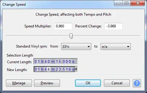

I was able to accomplish this using the Change Speed filter and then adding an initial delay to the track using the MKVToolNix GUI.
Note: This method does come with the downside of changing the pitch of the audio track slightly.
You may be able to minimise or even entirely eliminate this change of pitch by determining the delay to be added, manually adding it using Audacity's Silence filter and then using the Change Speed filter, but because I was dealing with a relatively unimportant audio commentary track, a slightly deeper pitch wasn't enough of a deal-breaker for me to warrant spending the extra time on.

  3. Select Effect > Change Speed. In the dialogue that appears, select the new desired length of your audio track (i.e. the length that you want the audio track to be stretched to):
  1. Click OK and wait for Audacity to process the track - this shouldn't take more than a minute to complete.
