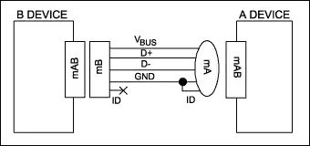

USB is not an equal peer-to-peer connection; it was designed with one device acting as the "host" (supplying power, assigning addresses, etc.) Normally the type-A connector always goes into the host and type-B connector goes into the "slave" device.
USB micro-B connectors have an additional pin indicating OTG (host) mode vs regular (device) mode. Actual "USB On-The-Go" adapters have this pin grounded, indicating to the phone that it needs to reverse the port's operation (switch to USB host mode and provide power, as opposed to receiving power).
Schematic stolen from the aforelinked Electronics.SE thread
Your "normal" cable does not connect this pin, because after all it was made to be used in normal mode (with the type-A end going into the USB host instead). So the connection has no device acting as the host.
The female-female type-A adapter cannot do this on its own, because type-A connectors predate USB OTG and do not have this pin (i.e. it doesn't even go all the way through the cable, it just loops back inside the type-B connector).
