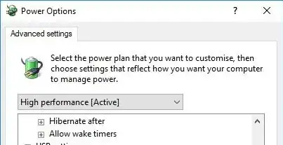

Reviewing Hidden Power GUID Options in Windows 10
Run elevated cmd, compare results by exporting:
powercfg /Q >%UserProfile%\Desktop\PowerPlanSettings.txt
powercfg /Qh >%UserProfile%\Desktop\PowerPlanSettingsHidden.txt
Find more information on hidden GUID in question by searching the registry.
- To unhide GUID use the following format in elevated cmd, be sure to use sub group heading also, this will make it visible in the power options window, replace the sub group and GUID with the one from the /Qh log:
Command Layout:
powercfg -attributes SUB-GROUP GUID -ATTRIB_HIDE
Command Example:
powercfg -attributes SUB_PROCESSOR 8baa4a8a-14c6-4451-8e8b-14bdbd197537 -ATTRIB_HIDE
- To rehide GUID use the following format commands in elevated cmd. Replace the sub group and GUID again.
Command Layout:
powercfg -attributes SUB-GROUP GUID +ATTRIB_HIDE
Command Example:
powercfg -attributes SUB_PROCESSOR 8baa4a8a-14c6-4451-8e8b-14bdbd197537 +ATTRIB_HIDE
