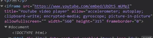

  3. select the iframe, you'll see something like this: iframe element with attributes;
    • if you happen to click an element within the iframe, don't worry, scroll up in devtools until you see the <iframe> element;
