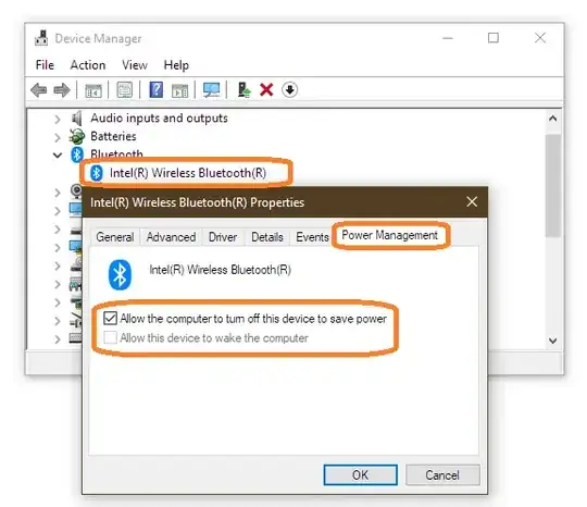

It could be that Windows is "aggressively managing power for Bluetooth devices". To change that setting:
  • Press Windows, type dev and select Device Manager.
  • Click on the caret [>] by Bluetooth to expand the list.
  • Right-click on each entry and open the Power Management tab.
  • Uncheck `Allow the computer to turn off this device to save power
  • Perhaps checking Allow this device to wake the computer might also help, though I've not tried that.
