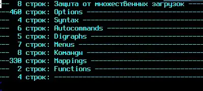

// I know about screen and altscreen on, but it makes either this (screen with TERM=screen):
or this (screen with TERM=rxvt-unicode):
while I want this (rxvt-unicode without screen):
rxvt-unicode
I have figured out that everything looks fine if I compile rxvt-unicode with USE=-xterm-color (in fact vim looks like on the second picture even without screen if I add this USE flag) and set TERM=screen-256color, but I do not like this workaround because it actually changes colors and I can't be sure that it will always change them only this way:
screen with TERM=screen-256color
