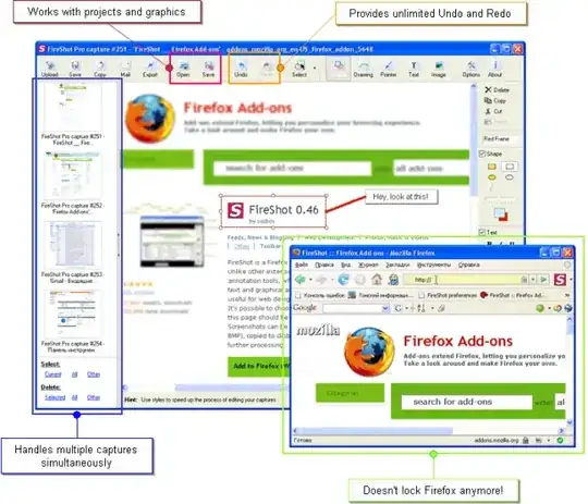

If you are using Firefox, the FireShot extension should do the job - it can capture just what's visible OR the entire page depending on what you want.
Daisetsu
  • 5,881
  • 44
  • There's also [ScreenGrab https://addons.mozilla.org/en-US/firefox/addon/1146/] – bobobobo May 26 '10 at 20:01
    One problem is that the Google Maps application intelligently resizes the map area to fit within the border of the browser window. However, I noticed that I can wrap it in an iframe that exceeds window borders. I'll try it today after work. – StackedCrooked May 27 '10 at 07:41
    These add-ons are merely answering the question «**How to take a screen shot**», not «**...something bigger than the screen**». To make web screen grab bigger than life, see [this superuser answer](https://superuser.com/a/1198900/717673). – SwiftArchitect Apr 12 '17 at 22:17
