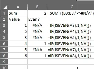

Per request from @JvdV, here is an example:
The formula in this cell and those below is =IF(MOD(A3,2)=0,1,"").
The intended output is to press Ctrl+Down and jump to B6, instead of B4.

If you do change your mind and you need the #N/A in the cells for chart purposes, you can both:
  • Use SUMIF to skip the #N/A values:
    =SUMIF(B3:B8,"<>#N/A")
  • Change the ChangeKey module to skip over #N/A values too
