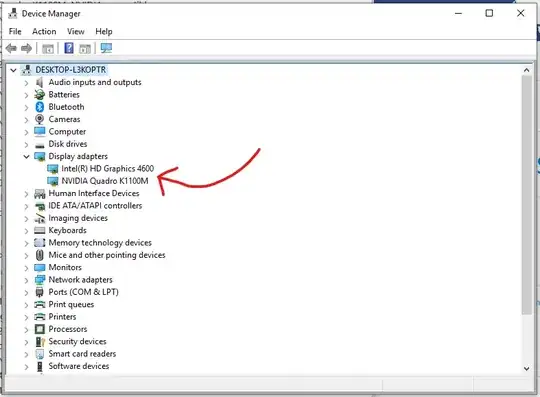

There are several ways to check what graphics options you have available to you:
System Information (msinfo32)
System Information output of Display info
Note: System Information shows details on the currently installed drivers for graphics adapters as detailed in this follow up screenshot from the same computer as above:
System Information output of Display info with IntelHD Driver removed
Device Manager (devmgmt)
Device Manager output of Display adapters
Popular 3rd party tools, such as CPU-Z:
CPU-Z output of Graphics tab showing multiple graphics options
Any of the above should be enough to determine if you have multiple graphics options, and, in the case of Device Manager, show if you are missing drivers.

  • CPU-Z is meant to tell you about the CPU and it is listing not just intel, but nvidia? is that to suggest that nvidia is somehow integrated into the intel cpu too? (or into whatever cpu you have?) – barlop Aug 25 '19 at 03:11
  • @barlop, no. Look at the tabs at the top of the window in the screenshot. CPU-Z will tell you about much more than just the CPU. There is also a GPU-Z that's more specific to the graphics. – kicken Aug 25 '19 at 03:31
  • Can attest to CPU-z showing what graphics adaptors there are. Also gives basic info on ram .... – Journeyman Geek Aug 25 '19 at 03:58
