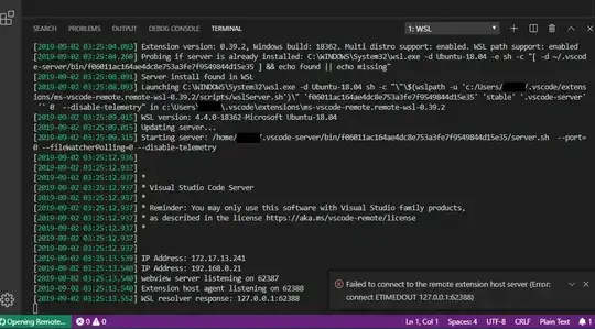

This is the output I get from WSL terminal in VSCode:
Failed to connect to the remote extension host server (Error: connect ETIMEDOUT 127.0.0.1:62388)
