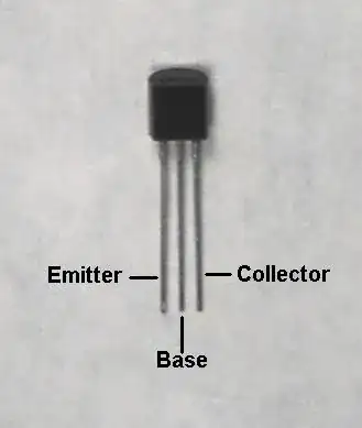

Take the simplest cpu, a single, lone, transistor:
alt text
Electrons lose energy as they bump around, generating heat. And overcoming the electric fields of attraction and repulsion requires energy.
