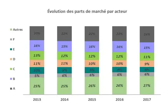

I have an Excel graph (a stacked bar chart) where years are on the x-axis.
The problem is that the order of the legend labels doesn't fit with the order of the values in the bars as shown in the picture below.
Image containing legend and bar chart, in which the order of the legend doesn't correspond to the order of the bars
How can I change the legend order or reverse it ?

    A screen cap of the table used to generate this chart would be useful to diagnose the problem – cybernetic.nomad Sep 11 '19 at 14:40
    @cybernetic.nomad I resolved the problem. It was not linked to the data table. I simply changed the place of the legend to right and then to left so I got the desired order. – Karima Touati Sep 12 '19 at 14:35
As Karima pointed out : the solution that works is simple, although not intuitive: Change the place of the legend to right and then to left (or reverse) and you get the desired order.

  • Both Left and Right had the reverse order for me, but changing it to Top and then manually moving & resizing it got it into to the correct order. – JounceCracklePop Dec 21 '20 at 22:13
This may help:
  1. Right-click on the graph
  2. Click on "Select data..."
  3. Use the arrows above the series list. Note : it will move the graph's bars as well.
Here's a screenshot to explain. Let us know how it goes.
Excel Screenshot
Luuklag
  • 133
  • l tried that methode but it didn't worked. It was not linked to the data table as well. I simply changed the place of the legend to right and then to left so I got the desired order – Karima Touati Sep 12 '19 at 14:37
