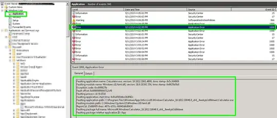

Event Viewer Details
Event ID 1000
Faulting application name: Calculator.exe, version: 10.1812.1901.4008, time stamp: 0x5c304989
Faulting module name: Windows.UI.Xaml.dll, version: 10.0.18362.356, time stamp: 0x0825b5b0
Exception code: 0xc000027b
Fault offset: 0x0000000000712cf0
Faulting process id: 0x1518
Faulting application start time: 0x01d568dbe3b0f42c
Faulting application path: C:\Program Files\WindowsApps\Microsoft.WindowsCalculator_10.1812.10048.0_x64__8wekyb3d8bbwe\Calculator.exe
Faulting module path: C:\Windows\System32\Windows.UI.Xaml.dll
Report Id: 23d86f95-8eec-407b-b52c-86043d6d0426
Faulting package full name: Microsoft.WindowsCalculator_10.1812.10048.0_x64__8wekyb3d8bbwe
Faulting package-relative application ID: App
  • enter image description here
