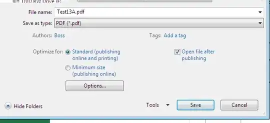

  • From File Menu click Save as.
  • Pick location, then from Save As Type drop down, select PDF.
You find this:
  • Select Standard Publication from Optimize For Radio Button.
  • You may also check the, Open File After Publishing Check box.
  • Now hit Option Button.
You find this:
  • Select an appropriate options as shown in Screen Shot above, or you may alter it as needed.
  • Now, finish with Ok.
  • Finally from previous Popup dialogue hit, Save button.
You find the PDF file open, then you may proceed in the way you want.
