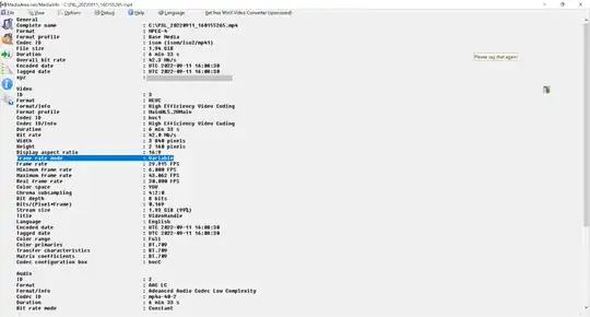

One can use MediaInfo (5 MB, crossplatform, has a portable version on Windows, gratis) to tell if a video has a variable frame rate:
