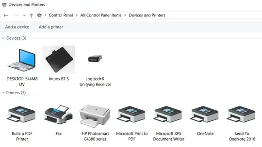

Also, I don't have seem to have any HP UPD item in my Devices and Printers page...
