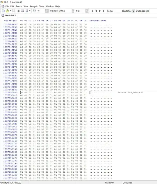

On further investigation, this appears to be a Cygwin bug that prevents the last 48 sectors of a drive from being wiped, although it's possible that this bug is entirely unrelated to the error message.
I tested by first writing a single pass of ones to the entire disk with:
badblocks -t "1" -vws /dev/sda
I verified that this was successful on the disk by running:
od /dev/sda
I then did:
dd if=/dev/zero of=/dev/sda bs=4M status=progress
...on the entire disk. This failed with the typical I/O error. Inspecting the disk using a hex editor shows that the entire drive was successfully zeroed apart from the last 48 sectors:
I worked out that 1953525168 sectors - 48 = 1953525120 sectors, and used this figure in combination with seek to wipe the last 48 sectors of the disk:
$ dd if=/dev/zero of=/dev/sda seek=1953525120
dd: writing to '/dev/sda': Input/output error
49+0 records in
48+1 records out
4294991871 bytes (4.3 GB, 4.0 GiB) copied, 0.230269 s, 18.7 GB/s
This successfuly zeroes the disk from sector 48 all the way until the end, which I again confirmed using a hex editor and od /dev/sda. Note the I/O error still exists when it reaches the end, indicating that the error does not necessarily indicate a bad wipe.
Finally, I booted Linux Kali from a bootable USB and wiped the entire disk with the same command:
Checking the wiped disk with a hex editor again confirms that the command wipes the entirety of the disk with no non-zero characters remaining.
