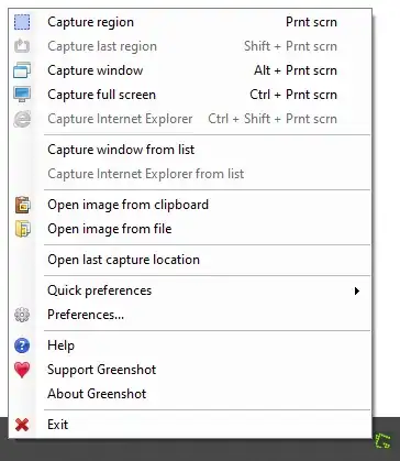

This error is telling you that the Greenshot process is still running in the background:
You can either close Greenshot by right clicking on its icon in the system tray, then choosing Exit:

Mr Ethernet's answer is correct. You need to exit Greenshot in order to uninstall it.
In response to 'In preferences the "launch at startup" is checked and greyed out.': This happens if you installed Greenshot with admin permissions, but run it as a "normal" user. Exiting Greenshot and re-starting it as administrator should enable the checkbox.
