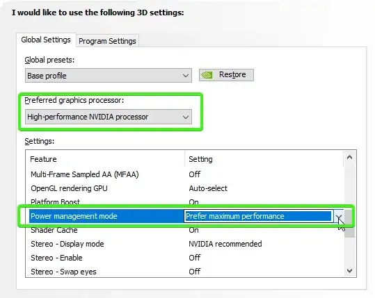

I have tried setting global nvidia control panel settings to always use the nVidia processor, and always "prefer maximum performance":

After much fiddling and troubleshooting, I have finally found an apparent solution to my GPU not always boosting clock rate appropriately during load:
In the nVidia control panel, I have selected each game/program that requires high performance, and individually set these programs to use the nVidia processor, and to prefer maximum performance:
Note that I had previously set the global settings to these same values (as per my original post updates), but that did NOT solve the problem. This may simply be an issue with current nVidia drivers, but apparently global settings are NOT truly global at the moment and/or global settings are unstable in some way.
