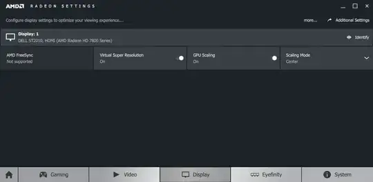

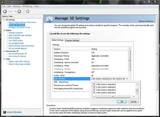

Both AMD and NVIDIA have Virtual Super Resolution (or Dynamic Super Resolution) configurations now in the latest drivers.
With AMD it should be pretty apparent in the Crimson driver.
Radeon Settings > Display > Virtual Super Resolution
As for NVIDIA, it's in the control panel:

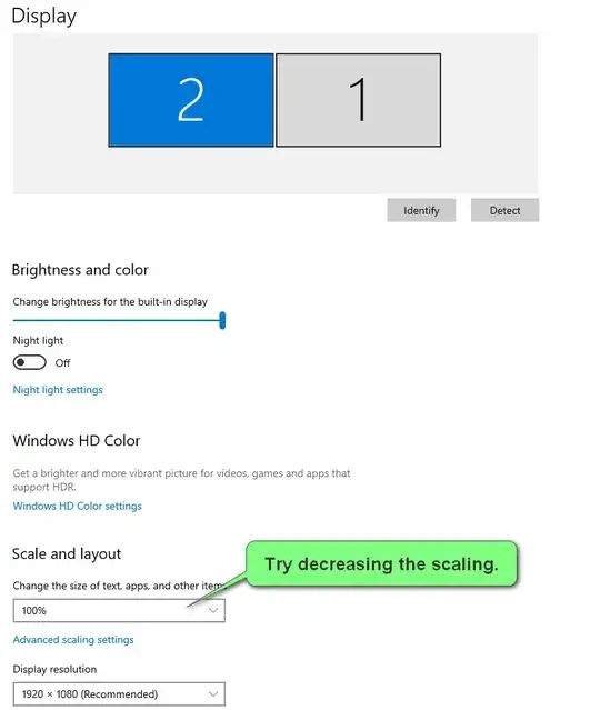

If you're using Windows you may want to check the text scaling !
You can configure this for each display individually. And it's worth noting that windows sometimes puts this at 150% by default.
It changes:
  • the height of the task bar
  • the sizes of the windows
  • because everything is bigger, it looks like the resolution is smaller.
So, while this isn't a way to increase the resolution. You may actually not even need to increase the resolution. It could just be the scaling that's configured incorrectly.
