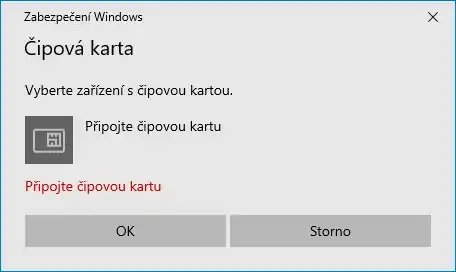

I have a SafeNet Token JC device that provides a certificate when I am connecting to a VPN using CheckPoint VPN Client.
I'm facing an issue that CheckPoint cannot see that device. I have Windows 10 and it worked almost a month without a problem. Last week I noticed I cannot connect to VPN anymore.
It says I should connect the smart card, but it is already connected.
I can see smart card device:

On other PC or even in VirtualBox on same PC on virtualized Windows 10 I can connect using the device and checkpoint without any problem.
Interesting is that I can see one more device on the other PC or virtualized computer - Smart Card - SafeNet Minidriver:
ex. Device Manager - Other PC
device manager on other pc with one more device
On my PC there must be some application/driver that blocks the device. But I can not figure out what is it.
