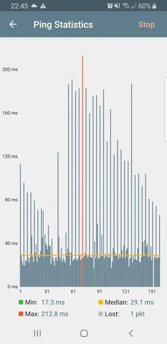

EDIT by jitter I mean my ping is steady (decent average) but the deviation is very high. Pinging my Router A using wifi I get 1-3ms but every few seconds it rises to 100-200ms

  • @Appleoddity by jitter I mean my ping is steady (decent average) but the deviation is very high. Pinging my Router A using wifi I get 1-3ms but every few seconds it rises to 100-200ms – andrepcg Jan 27 '20 at 09:19
  • I thought it could be my network (or a device inside) causing this issue, but I tried a public wifi nearby and the issue is still present no matter the device that connects. I even tried disconnecting all devices from my network and connecting one by one and the issue is still there as well – andrepcg Jan 27 '20 at 09:25
