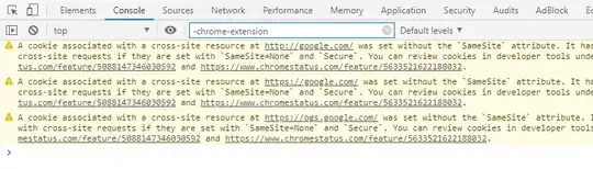

If you need to keep the relevant extensions enabled, then either @Webber's answer using Selected context only works well (but it won't stay set when you close and re-open Chrome), or OP @Richard_G's suggestion of a filter looks good (and stays set) - but I found the suggested filter was cutting out too much stuff:
Try just -chrome-extension as a filter instead, as demoed in the images below.

I have a temporary bypass which is kind of ugly. Hopefully, the vendors will get this worked out among themselves. What I did was to add a negative filter to the console settings, as follows. I am not going to mark this as an accepted solution.
-DevTools failed to parse SourceMap: chrome-extension:
Within a screenshot: enter image description here
