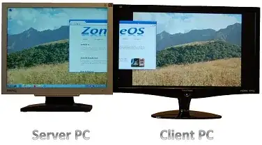

Here's an interesting freeware solution:
ZoneScreen
alt text
atom255
  • 1,002
    1. Windows Server 2008, Windows Vista and Windows 7 support is limited. (Aero must be disabled manually), and some BSOD reported under Windows 7. 2. It might be good to note that it is using Network connection between these computers – itsho Jul 22 '13 at 13:41
    Synergy has no such requirements or BSODs. – Collin Grady Dec 28 '13 at 07:42
    Doesn't work with Windows 8. No longer being developed. :( – Ƭᴇcʜιᴇ007 Apr 09 '14 at 15:13
    Synergy is an excellent solution to a different problem – Chris F Carroll May 24 '15 at 22:24
    I recommend using a program called "spacedesk" You just need to get the program loaded on both computers and know the IP address of the computer you want to add an extra monitor to. – Veridian Aug 13 '15 at 20:48
  • Spacedesk will cause serious issues with video games and computer streaming software, such as Open Broadcaster Software. It interferes with the video feed, causes games to crash and OBS will suffer frame loss or entirely not work. – Aaron Reed Jun 21 '16 at 19:50
