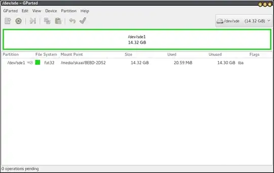

By comparison, another normally working USB flash drive (I got 4) reads like this:
normally working USB flash drive reads like this

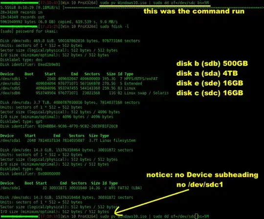

I'd read in some places that you're not supposed to output to the partition (sdc1) but to the drive (sdc), so I tried this:
sudo pv Windows10.iso | sudo dd of=/dev/sdc bs=5M
(which to those familiar is the same command, piped through dd, and with sdc instead).
This appears to nuke the entire partition, as you can see from fdisk:
my terminal output showing the command and fdisk
