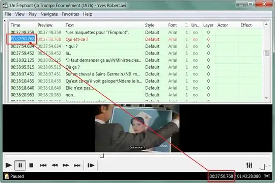

There are many subtitle editors on Windows or Linux but they do more than synchronize, and therefore are rather complicated for the simple purpose of fitting a subtitle to a movie. Many video players can delay/change the time of the subtitle in order to synchronize it but not many are able to save that change.
The simplest way I know is MPC-HC in Windows. It is also very powerful. I have seen it fixing subtitles that were a nightmare to fix with a dedicated tool.
See this specific answer with all the details on how to "Use Media Player Classic to resynchronize subtitles".
[*I am the OP of that solution, posted under a now dead account.]
Quoting from there:
Start the movie and load the subtitle (File Load Subtitle)
Go to View Subresync.
Select a certain line in subtitle table and when the movie reaches that line pause it.
Right click the Time value and click Current
Un-pause the movie to check the sub is synced.
File Save Subtitle; in case the new file is not loaded immediately, restart the player with the new subtitle.
