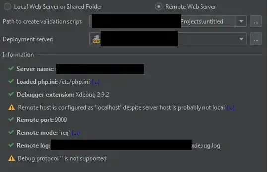

However, PHPStorm refuses to admit it can connect to XDebug. It validates the setup as all being OK, and can "see" the XDebug server. XDebug's remote log says the connection was successful, but PHPStorm thinks otherwise.
PHPStorm validates the settings (remember localhost is used because the port is tunnelled): enter image description here
