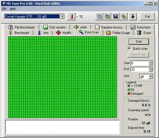

I use HD Tune Pro (Windows, $34.95 but free trial):
Also, there is Virtual Console USB Flash Drive Tester (mirror) (Windows, free):
