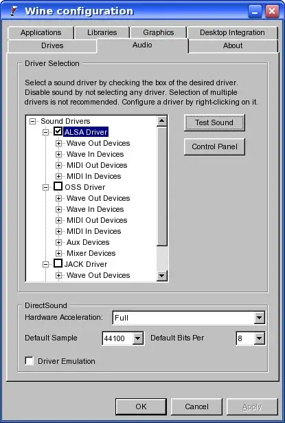

Ok, got it working by both removing alsa-oss and tweaking audio settings from winecfg. I changed from ALSA Driver to OSS Driver; see screenshot below.

1 Wine's audio configuration (winecfg) should look something this:
alt text
