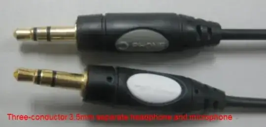

From ASUS KB - Why the external microphone can not be used after plugged into the Notebook audio combo jack?
There are two kinds of Headphones/microphone connector in the market.
  1. Three-conductor 3.5 mm separate microphone and Headphone.
  1. Four-conductor 3.5 mm headphone with microphone.
If you want to use the external headphone function, you can use both devices.
But if you want to use the external microphone function, the three-conductor 3.5 mm microphone will not work after plug into the Notebook audio combo jack(enter image description here).
Suggest to use a four-conductor 3.5 mm headphone with microphone device, the microphone and headphone function can be used at the same time.
