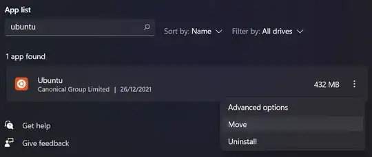

There seems to be a much easier answer to this, at least on windows 11 if your not really wanting to run around with powershell commands in your head.
Basically, install a distro. For example:
wsl --install -d Ubuntu
Unregister it:
wsl --unregister Ubuntu
This deletes your "root" drive as such, but doesn't remove the ubuntu image.
Go to Settings > Apps > Apps & Features, search for ubuntu, then click on the three dots button next to the result, should look something like this:
Ubuntu install thingo
Click on move, then just choose the drive.... go to the start menu (or hit the windows key or whatever works for you), search for ubuntu and run it which kicks off the installer.
Everything it does will now be on the drive you chose including the running disk image.

    Have you encountered the error " The publisher of this app doesn't allow it to be moved to a different location. The error code is 0x80073d21, in case you need it." – Graham Chapman Jan 29 '22 at 17:05
  • I couldn't successfully download the app with `Invoke-WebRequest`, so installing via the store and then moving it was the only way that worked for me. – Kit Johnson Mar 05 '22 at 09:43
  • Brilliant! This not only moves the VHDX but the whole WSL/ubuntu supporting files. For me, running this off of a PCIe4 NVMe drive, vs an old HDD, moving the whole kit and kaboodle is, I'd suggest, is the beast mode way of doing it. – kabammi Apr 06 '22 at 03:50
  • @GrahamChapman Yes, just tried to Move Ubuntu 18 on Windows 10 and got "The publisher of this app doesn't allow it to be moved to a different location. The error code is 0x80073d21, in case you need it." – AdamE Oct 25 '22 at 23:43
    For me on Win10, wsl version 1.0.3.0, the move was suceecesful. But when I tried starting from start menu I get error as *Error: 0x80071772 The specified file is encrypted and the user does not have the ability to decrypt it.* [screenshot](https://drive.google.com/file/d/15Y4heWtJ_BG4MAzWUctTnucREtc8nJR1/view?usp=share_link) – kiranpradeep Feb 19 '23 at 07:19
    same on Windows 11 Installing, this may take a few minutes... WslRegisterDistribution failed with error: 0x80071772 Error: 0x80071772 The specified file is encrypted and the user does not have the ability to decrypt it. Press any key to continue... – mLstudent33 May 06 '23 at 11:02
