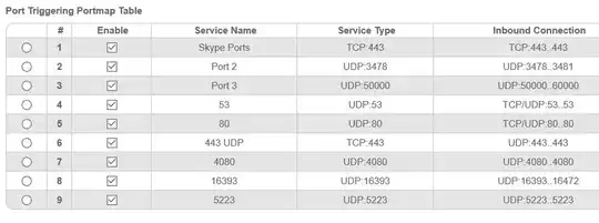

A recent and well-documented troubleshooting thread on Netgear's community forms detailed many issues that a customer had with both Skype and Facetime. There were many suggestions in the thread but none of them solved the issue on all of the customer's devices. Eventually, a solution was found for every device. The customer was given specific ports from Skype that he should forward/open on his Netgear router. Here is the image that the customer posted. This may also be a solution for you:
Here's an image of what my ports are now. Not sure what I started with and it doesn't list here what is for FaceTime. He worked so quickly that I didn't copy down everything that he changed. Service type is set to port triggering.

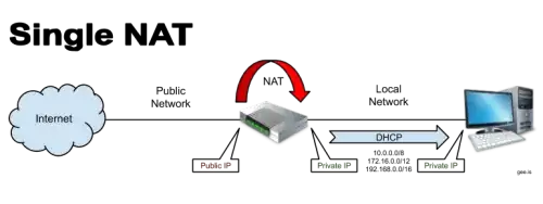

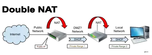

Now, if we add a second subnet/router to the mix. Things get even more complicated because we go from having Single Network Address Translation (Single NAT) to Double NAT.
So, Single NAT is necessary for most configurations and allows multiple devices on a local network to share the same connection via the same public IP address, how is this different from Double NAT?[3]
Everything technically works because static and dynamic NAT’s occur on each device which hops data across each device, the network is segmented at a layer 3 level so layer 2 protocols like DHCP do not conflict.[3]
Understanding Double NAT and its implications for UPnP
Problems arise mainly because the NAT tables on one device fill up or lose track of a particular connection, this type of configuration will cause issues with peer-to-peer technologies that are unable to effectively trace back the network path, MTU path discovery may not function or break and gaming/media services that use uPnP probably will not work unless [they reforward] these services manually.[3]

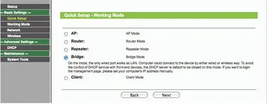

Using Bridge Mode
You can also avoid double NAT by using router 2 in Bridge Mode
Log into your router and browse through the various settings to enable bridge mode.
An example for TP-Link routers is seen here in the following photo:
