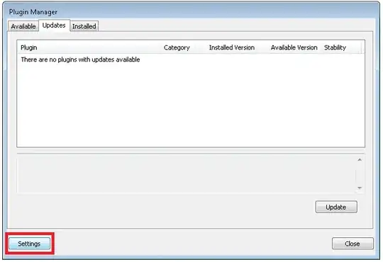

After I completed the steps bellow, I was able to update the Plugin Manager and install new plugins like XML Tools:
  1. Go to Plugins > Plugin Manager > Show Plugin Manager
  2. Click on Settings.
  3. Fill in the Proxy address and port - with your data
