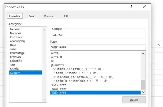

Good Day,
Assuming you only have 3 currencies you could use a conditional formatting to add the current ahead of the number without converting it to text. Please see the screen cap below. Notice it will still do math on these cells (the total in the screen cap. enter image description here
Its odd Excel shows the number component of the format as 38718 when it is #####
I hope this helps, Brad

  • Hi Brad, thank you for your input! Fact is - I got 46 different currencies here... Isn't there any way to tell Excel to get the "GBP" or "EUR" from a cell with specific adress rather than set it manually via custom format? Granted, it does work for small number of currencies and I can add the amounts with this formatting but it's tedious for 46 different currency codes and I would rather Excel recognized currency dynamically (by taking currency code from cells). Thanks again though! – Inquisitive_Torquemada Aug 18 '20 at 18:39
