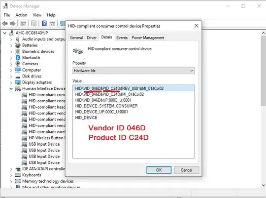

Basically USB devices have a class number (which isn't super unique across devices but does define the "type" of device), and a Vendor ID (VID) and Product ID (PID) that they tell the host when they connect. On Windows, in Device Manager, you can see the USB class number here under "Compatible IDs" ...
... and you can see the VID and PID under "Hardware IDs" ...
Illustration of USB PID/VID in devmgmt.msc
Device manufactuers get new USB VIDs from the USB Implementers' Forum, and the USB-IF also maintains the list of class codes.
The example above, if you look at this, you can see that Class 0x03 is a "Human Interface Device." An OS or other can support things based on class, or combination of class+PID/VID.
