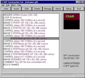

See Michael's Animated GIFs guide.
It describes the GIF Construction Set utility that can display the internal structure of the animated GIF (unfortunately not for OS X). Especially of interest is:
The LOOP control specifies how many times the series of images will be presented. While many animated GIFs are on infinite loop, this can be distracting to the user. This 'noframes' GIF cycles 5 times.
It's harder to find free OS X utilities for editing GIF files, especially since I'm not a Mac user. One that seems to fit the bill is Gifsicle, which can set the loop through the "loopcount" parameter.
