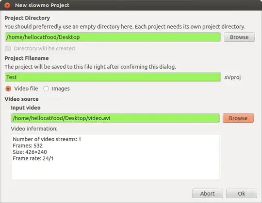

slowmoVideo is able to speed up and slow down video
slowmoVideo is an OpenSource program that creates slow-motion videos from your footage.
But it does not simply make your videos play at 0.01× speed. You can smoothly slow down and speed up your footage, optionally with motion blur.
How does slow motion work? slowmoVideo tries to find out where pixels move in the video (this information is called Optical Flow), and then uses this information to calculate the additional frames.
First download and install the program. When it is loaded go to File > New and select your video file.
With your video loaded draw you curves (by clicking on an empty area) to describe how the video should speed up and slow down.
When you have finished go to File > Render (Ctrl + R) and choose a directory to save your video

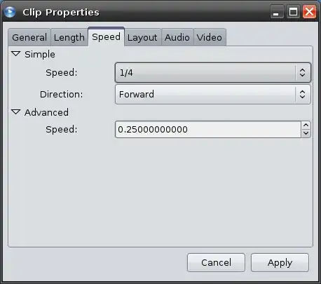

openshot is a movie editor in linux. you can download and install it free: openshot .
then you must go clip properties and speed tab, then you can change speed of your videos and export them
