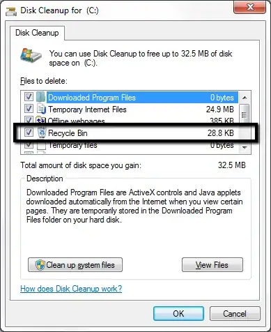

It was suggested on the Microsoft forums (here and here) that running the Disk Cleanup program will provide the total size of all the files inside the Recycle Bin. There's no direct approach similar to what was implemented previously in Windows XP.

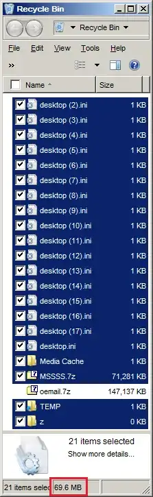

Anyway, what you want is a solution. It turns out that the simplest solution is to use the free shell-enhancer Classic Shell, which is meant to fix Windows by restoring the shell to how it was in XP which everybody was happy with for the most part. In addition to all the other things it improves, one of the things it restores is the ability to see sizes in the Recycle Bin. It shows the size of all selected items no matter what is selected or how many items are selected (figure 1).
Figure 1: Screenshot of Windows 7 Recycle Bin with Classic Shell installed, showing the size of 21 selected bin items including shortcuts and folders.
Screenshot of Windows 7 Recycle Bin with Classic Shell installed showing size
