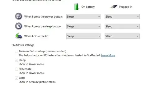

3- Disabled fast startup

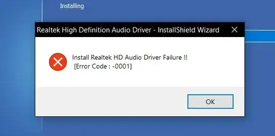

6- Installed r2.81 which causes the following error when after I restart the PC. So I uninstall 2.81 and install r2.82 instead.
7 - Installed r 2.82 - back to square one. Here is what the Realtek folder looks like
