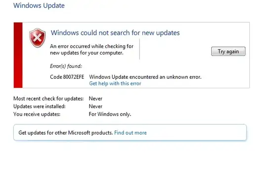

I have a HP PC. Recently, I have reset it, and it downgraded from Windows 10 to Windows 7. After the reset, I am trying to install windows updates. But when I try to search for new updates, I get the following error:
I did some research, and attempted all the solutions below with no success:
  1. Enable and disable Background Intelligent Transfer Service, Windows update, and Cryptographic Service in services.msc at windows run
  2. Clean the folder C:\Windows\SoftwareDistribution and deleted the folder C:\Windows\System32\catroot2
  3. Tried to install windows update KB3138612. In fact, I tried all the variant updates listed in the link. All of them result into The update doesn't apply to your system
I am really running out of ideas. What should I do in order to be able to install windows updates to my PC?
Here is a list of the updates installed on my PC so far. Sorry that it is in French enter image description here

I think the version you installed is too old to contact the Microsoft servers.
I suggest:
  1. Follow the article Windows 7: How to Check if Service Pack 1 is Installed to see if SP1 is installed
  2. If SP1 is not installed, download it and install
  3. Two updates are required for the next step. The first one below is sometimes sufficient, but installing both is safer:
  4. Download and install KB3125574 the so-called convenience rollup for Windows 7 SP1, which is a misnomer for the never-arriving SP2 service-pack.
    Even if Windows Update is working after the previous step, installing this roll-up is equivalent to a service-pack in that it clears up all the previously installed updates, just the same as a service pack, with a net gain in disk space. It will also be faster than installing separately all the updates that it contains.

Servicing update KB3020369 does not solve the issue. Perhaps is needed as a prerequisite, I'm not sure.
It should not harm to install; it did not require restart.
For me, KB3138612 did solve the issue.
Prior to KB3138612 installation, runas cmd.exe displayed the executable as unsigned.
After installing, cmd.exe runas appears again as signed.
Note. KB3138612 does require restart.
    This is the correct answer. Only KB3138612 is required to get Windows Update working again. There may be prerequisites. In my case, this worked on a stock install of 2008 R2 with SP1. – Zhro Jul 13 '21 at 01:10
    Yeah I doubt the KB3020369 is even a pre-requisite... You're right that it's KB3138612 that is needed. Infact the description for the 612 one says update for windows update. Clearly probably jst the 612 one is needed – barlop Aug 25 '21 at 18:28

KB3138612 did solve the issue for me without any additional steps on restored Lenovo Win7 Home 64bit Intel system.
https://www.catalog.update.microsoft.com/Search.aspx?q=KB3138612
Note- others have simce indicated this is actually the one needed.
