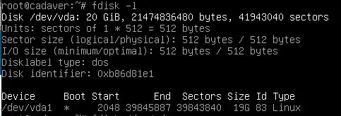

This might seem scary but it's safe. First, open a tmux or screen; you do not want to do that over a session that might go down due to a network glitch. Second, run fdisk -l /dev/sda and copy somewhere the output. It will be something like this:
Get a snapshot of it with your mobile, put it on paper, but copy it. Then the tricky part. You want to delete sda2 and recreate it with the same starting sector and a higher ending sector, or just hit enter and it will be extended to the end of the available space. If needed change its type to the partition type listed under the Type column of whatever fdisk -l /dev/sda's output says. An example session would be like the following:
In this case the disk is vda and the partition vda1, but the procedure is the same. All you need to do next, is extend the file system, which you will accomplish with the appropriate tool for the file system you're using.
