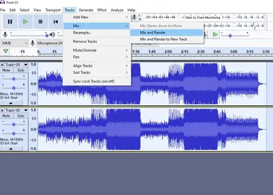

An alternative, and in my opinion, easier way to calculate the difference between left and right track:
Click on the track, and then "Split Stereo Track"
Split stereo track
Click on the second track, and then "Effect/Invert"
Effect Invert
Set the panning of both tracks to center, select everything, and click on "Tracks/Mix/Mix and Render"
Mix and render
The result is the difference of both tracks. If it is zero, then it's the same track on the left and right sides. In this case, it's not.
Result

For comparing the two channels, the post Comparing two supposedly identical tracks has this advice that uses the free Audacity:
Import them both into Audacity. Apply the "Invert" effect to one of the tracks. Select both tracks, then from the "Tracks menu > Mix and Render". If the tracks were identical, the result will be silence. To check that it is absolute silence, select the full (mix) track, and open the "Amplify" effect. If the Amplify effect says that the "New Peak Amplitude" is "-infinity", then the mix track is totally silent and the two imported files have identical audio.
The post contains much discussion that will interest you and some alternatives.
