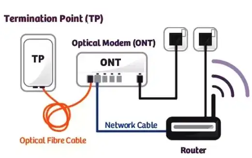

I do not want to use ISP provided fiber router. I want to use my own router that has WAN port in Router Mode (not AP). After searching the net I came across this diagram (image sourced from Quora.com)
That raises a few basic queries in my mind
  1. Is the above setup or something similar I need? Do I need an ONT between fiber and WAN port router?
  2. Does that ONT require any configuration or is it just plug n play?
  3. If any configuration is needed, does it get IP address and how to connect to it?
Yes, it's a regular setup for GPON fiber Internet.
If your fiber Internet connection is using GPON technology (as opposed to "plain old" fiber Ethernet), then yes, you need an ONT (aka ONU) as it's the device which actually understands how to connect to a GPON network.
(GPON is a passive/broadcast type network, not point-to-point, so there are complexities involved – the ONT keeps track of its timing slots for sending data and decryption keys for receiving.)
Note that each ONT has to authenticate to the network (as the ISP can't just directly associate the physical line to a single customer) and there is no guarantee that your ISP will let you connect just any random device.
Many ISPs issue "fiber modems" which are combined ONTs+routers, but the ONT doesn't need to be a router – its primary job is just to be a fancy media converter, and it can act as a pure layer-2 bridge to the ISP's "WAN" network. My local ISP always provides them as two separate devices and allows any router to be connected to the ONT's Ethernet port (directly obtaining a public IP address via DHCP).
As far as I know, there are several ways that the ONT can be authenticated: by its serial number (unchangeable); by serial number + password; or by LOID (changeable) + password. So it is possible that the ISP might ask you to enter a specific password and/or LOID into the ONT.
(Some ISPs don't use ONT authentication and will want router-level PPPoE configuration instead.)

    In my country the CPE provided by the ISP is actually required to allow the usage of your own router by law. They solve this by letting the user switch the router to "bridge mode" so that it acts, as you explained, like a layer-2 device. Perhaps it would be worth to check if the router provided by the ISP supports this or if there is any regulation on that? – jvda Apr 21 '21 at 08:02
Looks ok, but somewhat overcomplicated setup. You can feed ISP WiFi router LAN output directly to your WiFi router WAN input. However this way you end up with 2 WiFi routers.
Are there any strong arguments against replcing separated modem + your WiFi router with an integrated modem WiFi router from your ISP? Presumably you should be able to configure ISP router in a similar way as your current router.
In case ISP WiFi router is not acceptable, you should be able to switch off WiFi on ISP router and only use LAN connection to your own WiFi routers WAN port.

  • Any arguments against eleminating your router instead? If you don't want ISP fiber router, then you need separate modem or your own router must be fiber router. – dmmedia Apr 20 '21 at 11:48
  • @rajeev Perhaps the simplest solution would be to check if your router supports bridge mode. In that case it would behave purely like a modem and you just transparently forward all traffic to your device which you can use as the actual router. Does the ISP router support that? – jvda Apr 21 '21 at 07:58
  • @jvda Thanks. question updated. See Edit1. – rajeev Apr 21 '21 at 09:57
