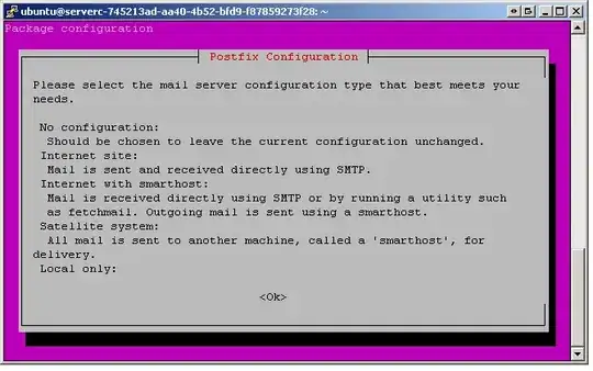

Note that if you also want to automatically go by the default answers when an interactive prompt appears, you can use DEBIAN_FRONTEND=noninteractive
Single install:
sudo DEBIAN_FRONTEND=noninteractive apt-get -y install [packagename]
E.g.:
sudo DEBIAN_FRONTEND=noninteractive apt-get -y install postfix
All updates:
sudo DEBIAN_FRONTEND=noninteractive apt-get -y update
You can set up finer options with -o Dpkg::Options::="--force-confdef" and -o Dpkg::Options::="--force-confold".
Examples:
apt-get update
sudo DEBIAN_FRONTEND=noninteractive apt-get upgrade -y -o Dpkg::Options::="--force-confdef" -o Dpkg::Options::="--force-confold"
or
apt-get -o Dpkg::Options::="--force-confdef" -o Dpkg::Options::="--force-confold" dist-upgrade
Example of interactive prompt:
Interesting read: Perform an unattended installation of a Debian package
