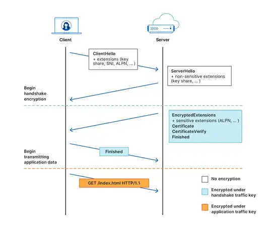

In TLS 1.3, all messages after ServerHello are encrypted – the actual Certificate message is hiding in the "Application Data" packet in line 3.
The ChangeCipherSpec message is meaningless in TLS 1.3 and is only sent to appease various middleboxes (firewalls, intrusion detection systems, etc.) which have some overly strict assumptions about how a TLS handshake should look like.
For the same reason, the encrypted handshake packets are sent as an "type = Application Data, record_version = TLS 1.2" even though they're neither TLS 1.2 nor application data.
Basic handshake diagram
Image borrowed from Cloudflare blog

    Thanks, so the key exchange (key share?) happens immediately then the certificate is verified later? The client decrypts the second server message with the shared key and determines whether the certificate and other information inside is valid and then decide if it wants to now send encrypted messages with this server. – masonCherry May 11 '21 at 16:18
