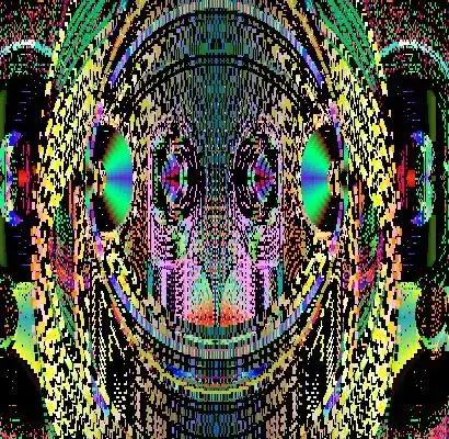

Try the interactive music visualization program (real-time) on this site.
It works by any displaying of sound file on a Windows (at least) computer. The program is interactive, real time and includes many essentially different variants. As I can judge it provide much greater correlation with music signal that other music visualization programs.
