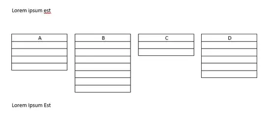

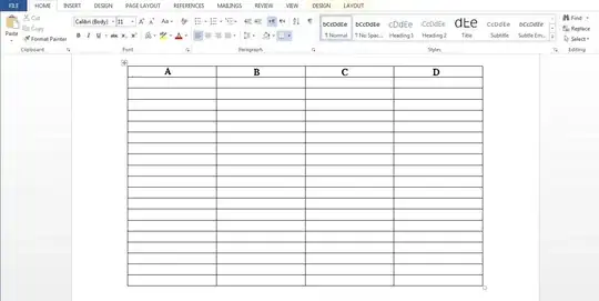

I want to create a table with 4 columns and many rows in MS Word 2013. I want to split the table vertically into 4 tables close to each other (e.g. 10 mm distance to each other).
I saw some tutorial on the Internet but they usually teach splitting table from rows, or if it is vertically they are not clean and direct (drag and drop methods where they are appropriate for small tables) and they are not good for tables with many rows. I made a sample with MS Paint here.
Do you have any hints.
Before:
A single table with 4 columns
After:
4 tables

Section Break (Continuous)
Table A         Table B        Table C        Table D
Column Break    Column Break   Column Break   Section Break (Continuous)
Add section breaks. Format that section to have 4 columns. Add a table, then column break, then table, etc. You'll end up with four tables that are independent of each other and display as you desire. You'll need a new line after each column break or Word will merge your tables. You can change the line spacing and font size for that new line, though, so it all but disappears. Fiddle with the column gap to make them as close as you like. 10mm is about 0.4 inches.
With formatting marks: Formatting marks
With formatting marks and the new lines shrunk down: Formatting with little lines
Without formatting marks: Clean
