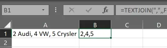

With Office 365 or 2019 Excel we can use TEXTJOIN and FILTERXML.
=TEXTJOIN(",",,FILTERXML("<t><s>"&SUBSTITUTE(SUBSTITUTE(A1,","," ")," ","</s><s>")&"</s></t>","//s[number()=.]"))
The FILTERXML parses a made up string that looks like xml. We substitute the spaces and the commas for </s><s> then only return the nodes that are numeric.
The TEXTJOIN takes the array returned and adds a comma between each element.
